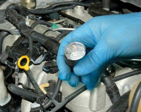

Have you tested the injectors for pulsing?

So you dont know if the injectors are pulsing?

OK, my new noid light set came in today , tomorrow my new fuel pressure set comes in but it will probably be just like the noid light set , deluxe set , 10 lights , not a one of them fit the plug on my car , but it dosnt matter , the new fuel pump quit pumping fuel , it runs and all, but doesn't pump a drop of gas , a bit ago i painstakingly copied down every one of the codes , starting with po201 through 204 ( could have found out how true that is if one of the noid lights had worked ) ok here it goes. po201 through 204, p1137 and 1138, po106, po108, po462, po112 and po113, po122 and po123, po125, po131 throuigh 134, p1133,po137 and 138, po140 and 141, po171 and 172, p1171,p1134, p2ao1, po300,po420,po455, po496, po442, po446, po480, po502 and 503, po506 and 507 po530. will try and make a jumper lead today to fit one of the lights .

FINALY GOT SOME TIME TO GET BACK TO IT , the noid lights flash on all injectors , then the fule pump quit again, now it will sound like its running , but will pump 0 pressure. unless i pull the pigtail down by the tank and reverse the positive leads , then it will pump. pulled the ecm plug and inspected closely then blew all out with an air hose now it wont eveen run when i spray eather in and crank it ,
