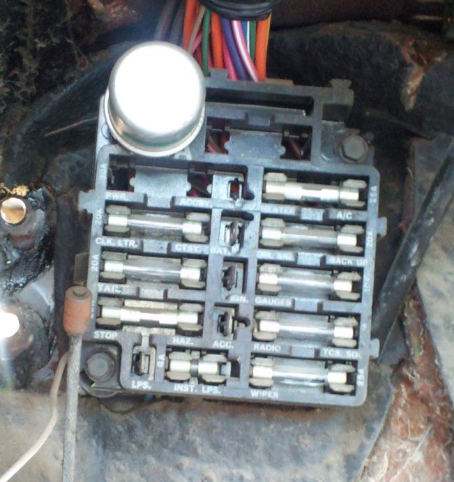

Heres the update All the electric is fine except for two things .when I press the lbrske pedal the drivers blinker lights up and the interior light looks like its on a negative switch what fuse is it under.
The turn signal indicators are lighting when braking because the 4 way flasher switch is on and the flasher unit in the fuse panel has been removed or is non functioning.
The dome light is on the clk ltr ctsy fuse in the photo. Or in whole words, clock, lighter courtesy fuse.

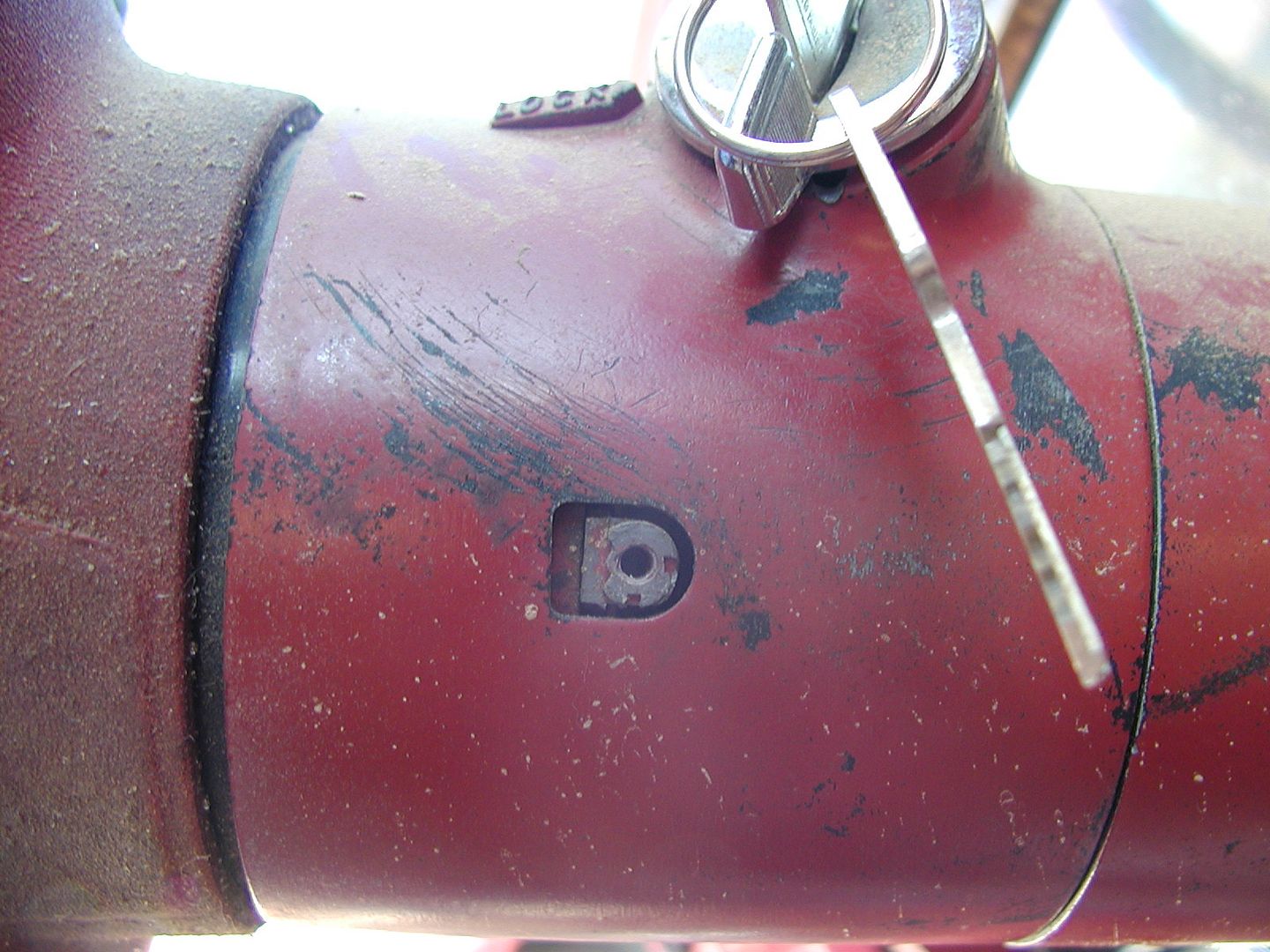

The flasher by the radio is for the turn signal lights, the one in the upper left of the fuse panel is for the hazard flashers. The hazard flasher switch is on the passenger side of the steering column and when pulled out it is in the off position.

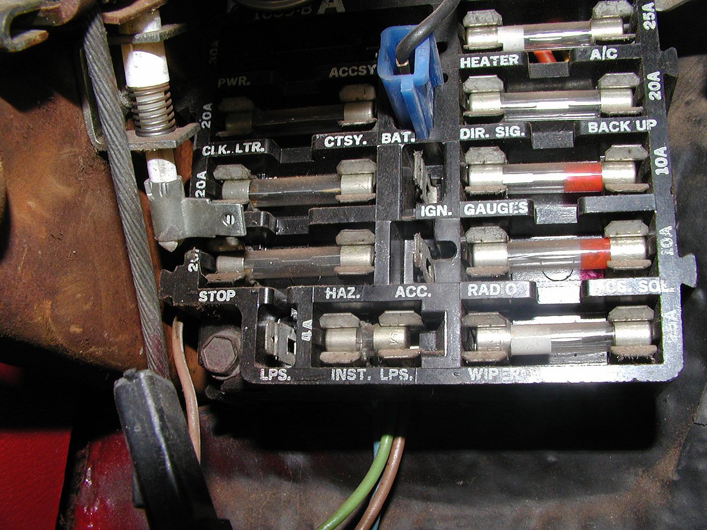

Here is another shot of a Nova fuse panel
The hazard switch location, this photo is with the knob removed. If this switch is pulled out the front signals should not longer operate with the brake lights.
