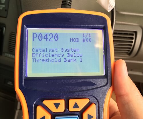

Hi I own 2018 traverse high country and I have a big problem I don't know how to solve I have the codes P0420,P0442,P0446,P0496 .. I bought a used charcoal canister and its added the code P0449 when I return the old vent solenoid to the new charcoal its return to only 4 codes
I replaced the purge valve twice and it get bad within days
And now the car is unstable especially after brake and I feel it can't go fast easily
You should be chasing the P0420 code before the others. You may have a clogged cat. Read this link and check the other codes on this site.
