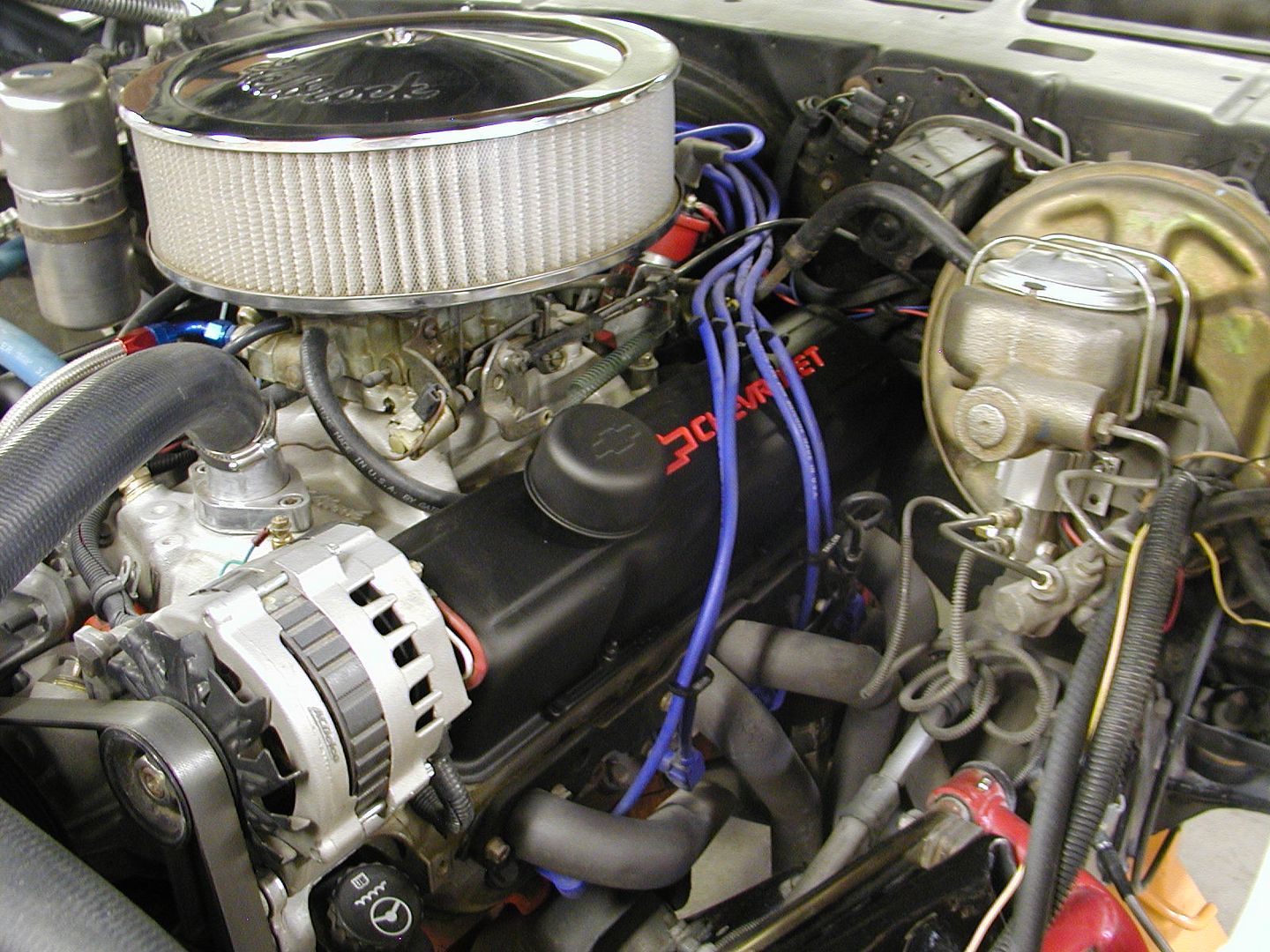

Here is the install on my V8 77. IIRC it is 100 amp. I have the wiring diagram somewhere too. I will find and post it for you.
The stock 6 and V8 alternators mounted the same and used the same wiring. A new style can be added to your car too.
