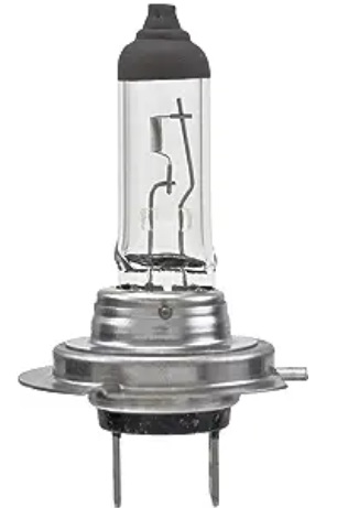

Bought a 2018 with a left headlight issue. bulb was dim so when I went to replace it the new bulb H11 did not match the H7 that was in there. the socket is different. both sides match the H7.
The problem its having now is it wont adjust to point. The light is just diffused. I believe the car had frontal damage at one point. When I turn the lights on, the left one is dim, flip high beams on and off and
the left light turns on but its diffused all over the place. The adjuster does nothing.
Sounds like the wrong or an aftermarket lamp was used. Sylvania web site shows H11.
I know, all the books say H11, even rock auto BUT....the harness/connector is different. I doubt someone changed out the wiring
harness to install new or different head lamp units. Very strange.
