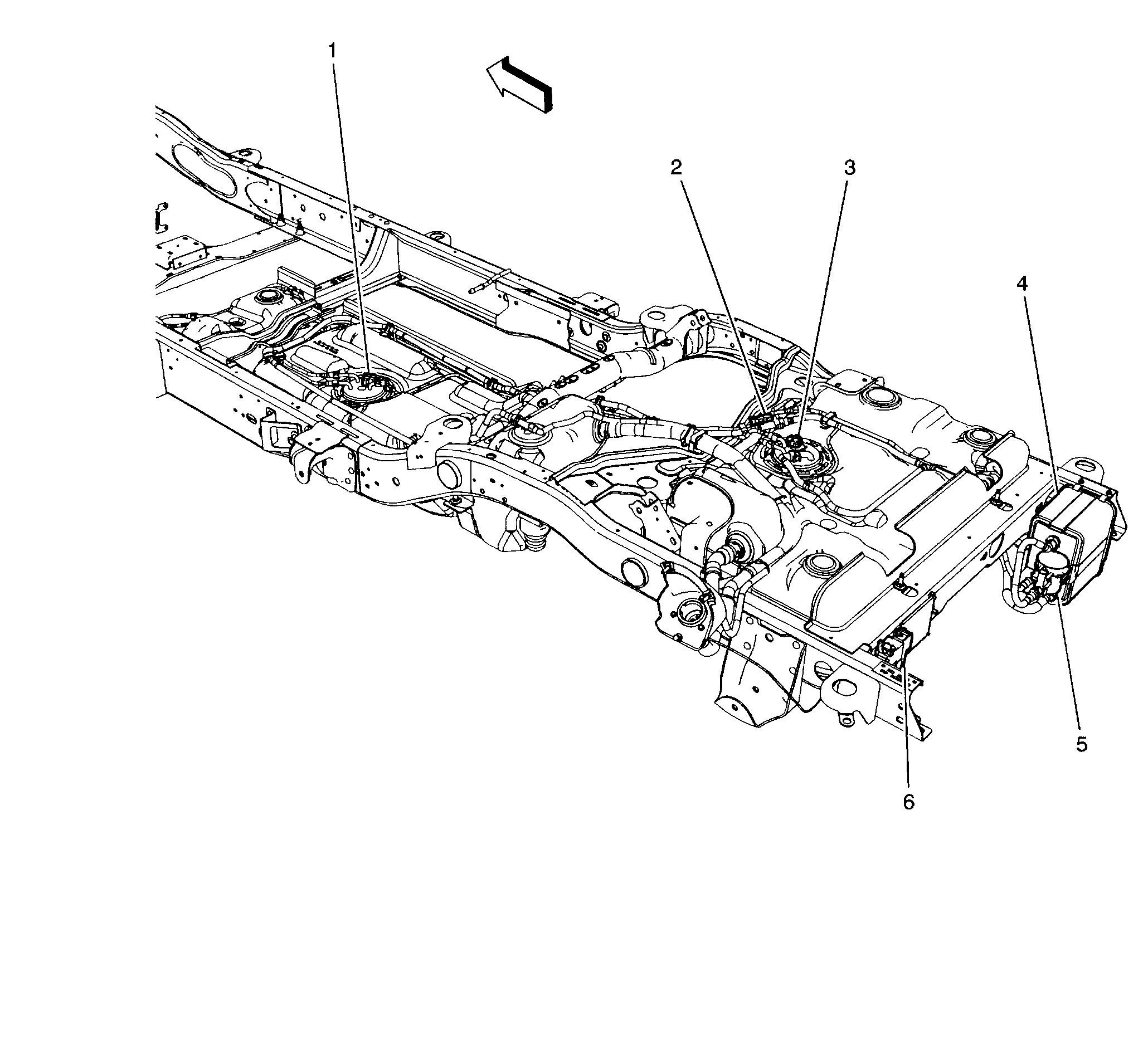

I have a 2007 Suburban 2500 LS and everything I read says it has a 39 gallon fuel capacity. Over the last 60K miles, I have proven that to be true. In the last few months, it has been running out of gas with about 4-5 gallons remaining. It will be fine, with the guage just below one-fourth, driving along and the low fuel light comes on and within a minute, it stalls. When I get it to a gas station, I can only put 35 gallons in it.
I had it on a lift recently and it appears to have two fuel tanks. The fuel fill tube splits and one side goes to a coffin sized tank and the other side goes to a smaller tank above the spare.
If I do have two seperate tanks, do I have two fuel pumps? If so, would it make sense that the smaller tank is not getting to the fuel system? It appears so in this picture.

I really doubt there is a second tank, in all probablity you see the evaporative emissions tank used to separate fumes from gas. You may have a problem with the float in the tank feeding incorrect readings to the computer.
Anyone with knowledge of this fuel system?
It looks like two tanks, pumps, plus the evap canister.
