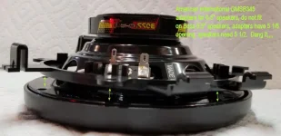

The GMSB345 adapters may very well fit into the speaker installation holes,, but like I said,,,, the 6.5" speakers I have, are too big a-round to fit into the adapters,,,,,[ speakers were a gift from my son, and they were listed as fitting a 2002 Burb. ] so,, hopefully I can screw mount the speakers directly in the speaker holes in door,,,,,that is my plan at this point,,,,, instead of buying smaller speakers,,,,
Boss 6.5 speakers

Cool,, like I said my Boss speakers were a gift,,,, they needed a 5 1/2 in cutout,,, my door adapters only allowed about 5 1/4,,, 5 1/8 inches,,,, so just drilled holes for front door speakers,,,, and used existing holes in door for rears,,,I have a new 8" rear deck woofer,,,,just no time to install it yet,,,,
